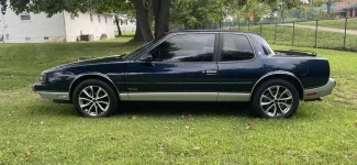

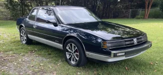

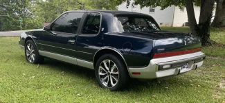

I had been looking for wheel options for my 1988 Oldsmobile Toronado and ran across an option on Facebook Marketplace I wasn't expecting. I looked up the specificarions and discovered that I had a new option.This option was from a 2021 Chevrolet Equinox LT. Going from the stock 15x6, bolt pattern of 5x115 with a center bore of 70.3 mm with tire size of P225/65R15 to 17x7,bolt pattern of 5x115 with a center bore of 70.3 mm with offset range of 39-43mm with a tire size of 225/55R17. This past week I personalized these wheels by painting the "wheel window inserts" a contrasting gloass black. I'm very happy with my results.
