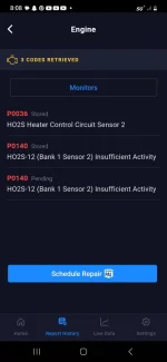

Last time I messed with it I reset the codes these were the ones that came up . I don't even think it started at this timeScreenshot_20230710_200813_RepairSol2.webp
Also have done the security reset before and after the ignition switch. Before resetting the codes it was showing like 60 plus codes for literally everything. Have not been able to check fuel pressure other than pushing on the valve and some sprays out. Also when it'd not starting you can smell gas almost like it's flooded
