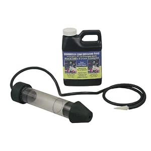

1) Check for exhaust gases in the coolant. There are kits, use google.

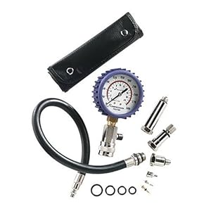

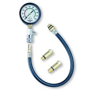

2) Do a compression check.

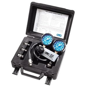

3) Do a leak down test.
A leak down test is best. Since I have a leak-down tester and compressor, *I* would do a compression and leak-down test first on the front three cylinders. The back cylinders can be a huge pain to get to.
It should be cheap and easy to do #1 and #2 (maybe $25 each for the stuff).
#3 requires a real air-compressor, and a decent leak-down tester is ~$80 (last I checked).

FYI:
Lisle 75500 Combustion Leak Detector
Price: $30.57
http://www.amazon.com/Lisle-75500-Combustion-Leak-Detector/dp/B0007ZDRUI/
Better, what I suggest:
http://www.amazon.com/UVIEW-560000-Combustion-Leak-Tester/dp/B000NPDL76/
UVIEW 560000 Combustion Leak Tester
Price: $54.73
