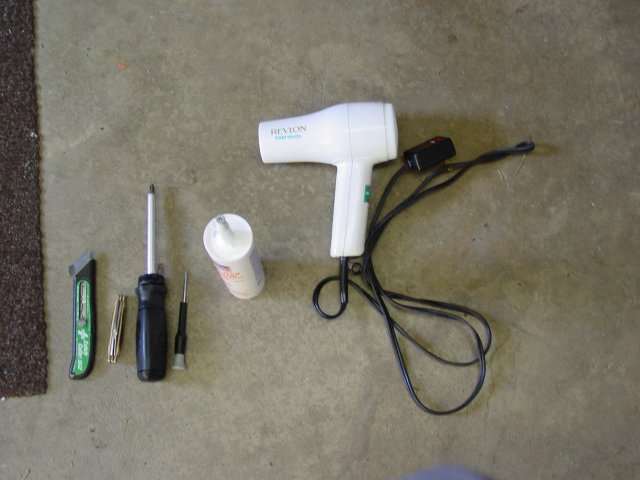

Here are the tools/items that I used during this. Utility knife, pocket knife, flat head screw driver, small flat head screw driver, silicone(I used clear, though any color should do), and a hair dyer/heat gun.

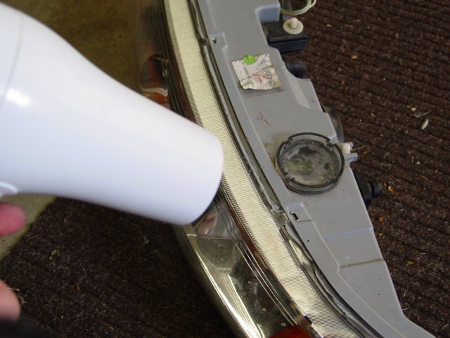

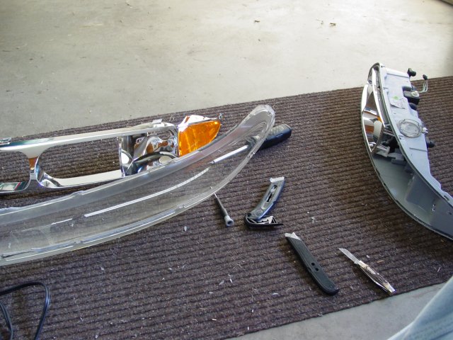

First things first. Heat up the silicone that is keeping the clear and grey parts of your headlight with either a hair dryer or heat gun. The hair dryer pictured above worked great for me.

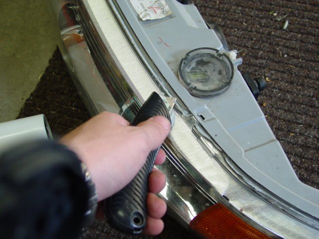

Next use a utility or exacto knife to make a cut in some of the old silicone that you will be removing later. After you go all the way around it and keep applying heat you should be able to start wigglying it. Just keep wigglying it around until you get it apart, mine came farely easily at this part. A flat head screwdriver can also be used to pry the pieces apart. This is exactly one of the easy parts, the next step I thought was harder.

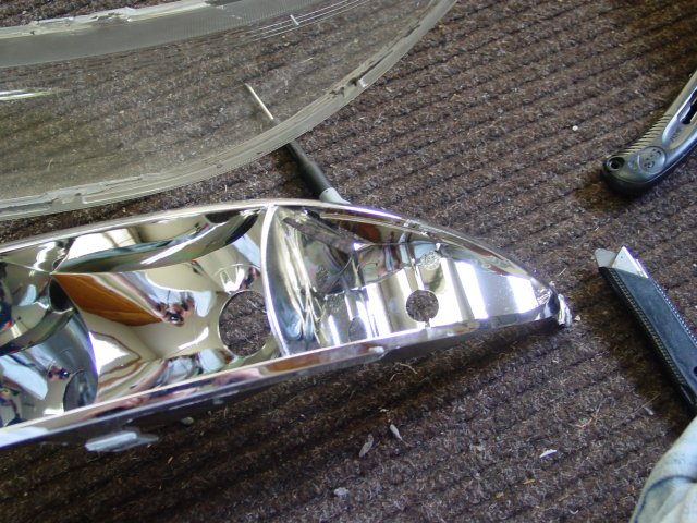

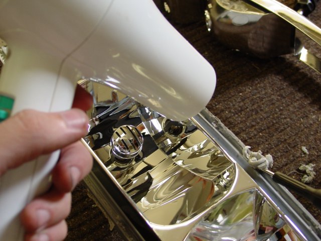

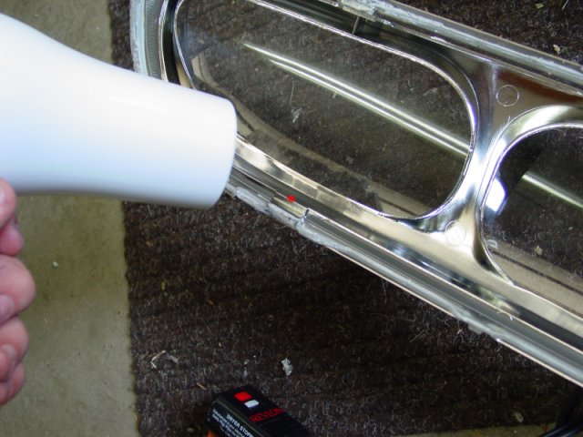

Thirdly you are going to start taking apart the inner assembly(the chrome piece that is glued inside the clear piece. This part IS a quite a bit more challenging and the chrome piece is kind of fagile so be CAREFUL. First heat up the chrome piece that is connected to the clear part(this is pictured below and is marked with a red dot). I also suggest doing the one all the way in the corner last(the piece is curved).

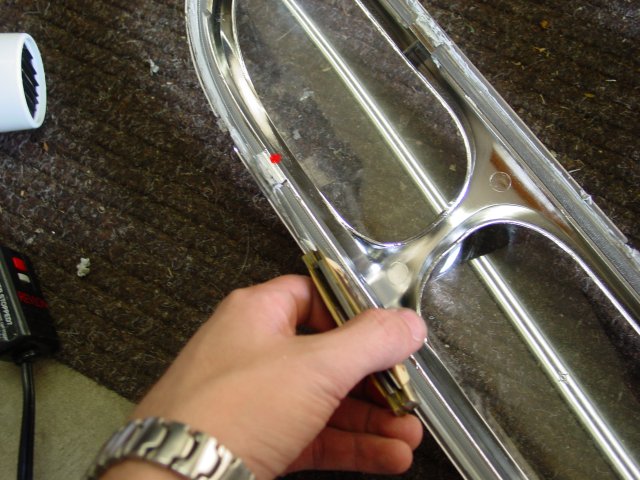

Once the part is well heated and I do mean well(almost too hot to touch) take any knife you feel sure about yourself with(I used a regular pocket knife and went up from underneath, this seemed extremely useful here each one gave away easily)

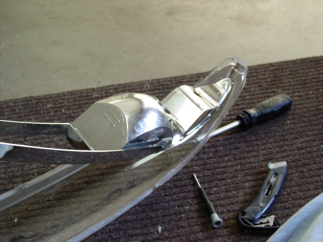

Here is a picture of the last piece to take apart. I just got it really hot and kept wigglying it back and forth, it should eventually start giving away and will just kind of bend right out. HOWEVER, be EXTREMELY CAREFUL here this part is extremely fragile here and very well COULD break off.
Here is a picture of the three pieces you should have after seperating silicone attached pieces.

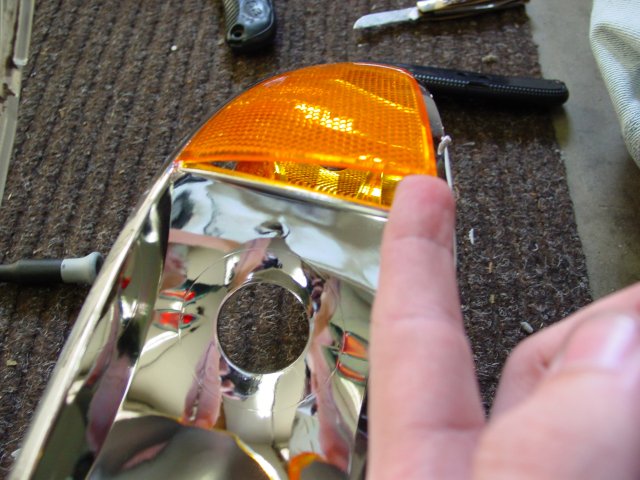

Next you need to take off the orange reflector piece. This is probably the easiest step in here. It just snaps in there so pull up where pictured below and it will come out with a little force.
Pic of the chrome piece without the orange reflector.

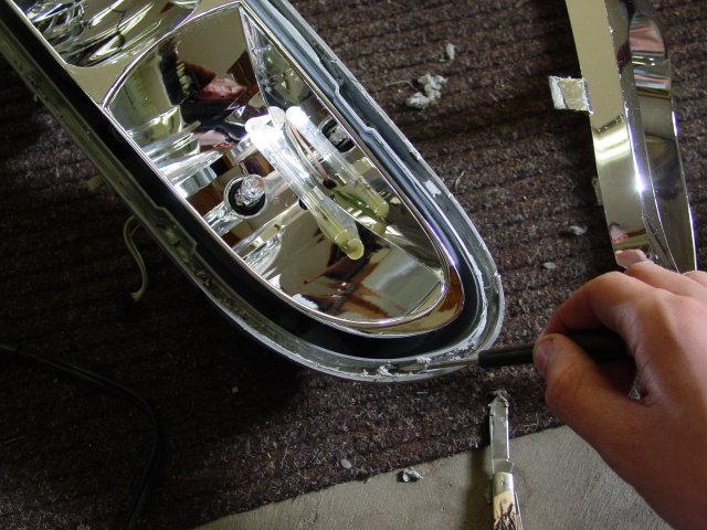

Then you need to start taking out/off some of the old silicone. I took most of it off but it shouldn't hurt anything if you leave some behind as long as you use a silicone that can be used to bond to another silicone. I suggest heating up the old silicone and then taking a small screw driver and run in the grove of the grey piece. For taking off the silicone off of the clear piece(not pictured) I just ran my utilty knife along the outside of it.

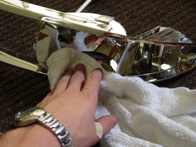

After you have that all cleaned out it is a good idea to clean all of the chrome and clear pieces clean of dust and finger prints. I used a dry terry cloth for this.
