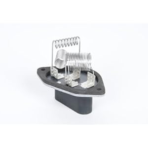

BTW, the blower resistor almost always fails as an open, not a short. The "resistor" is really just wires with specific properties and known resistance.
From: Fro the Achieva
http://www.amazon.com/ACDelco-15-80839-Blower-Resistor-Assembly/dp/B000EQRJ2M
ACDelco 15-80839 Blower Motor Resistor Assembly
Price: $16.37
For example:
Often, the blower resistor is next to the blower fan, because those wires often need air flow to keep them from overheating and melting.
