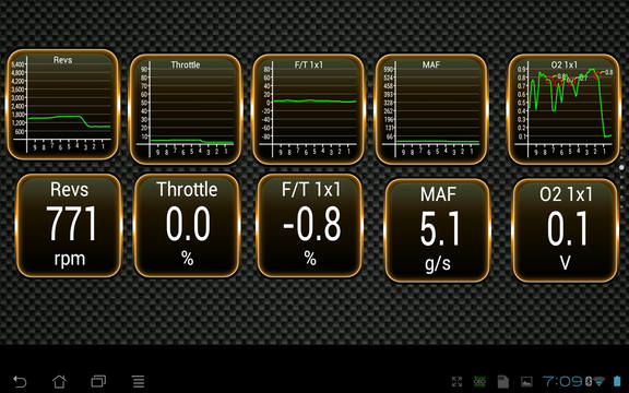

Also, below is a screen capture from my 3.5L using the torque app. So, your engine should be close to ~~5g/s.
