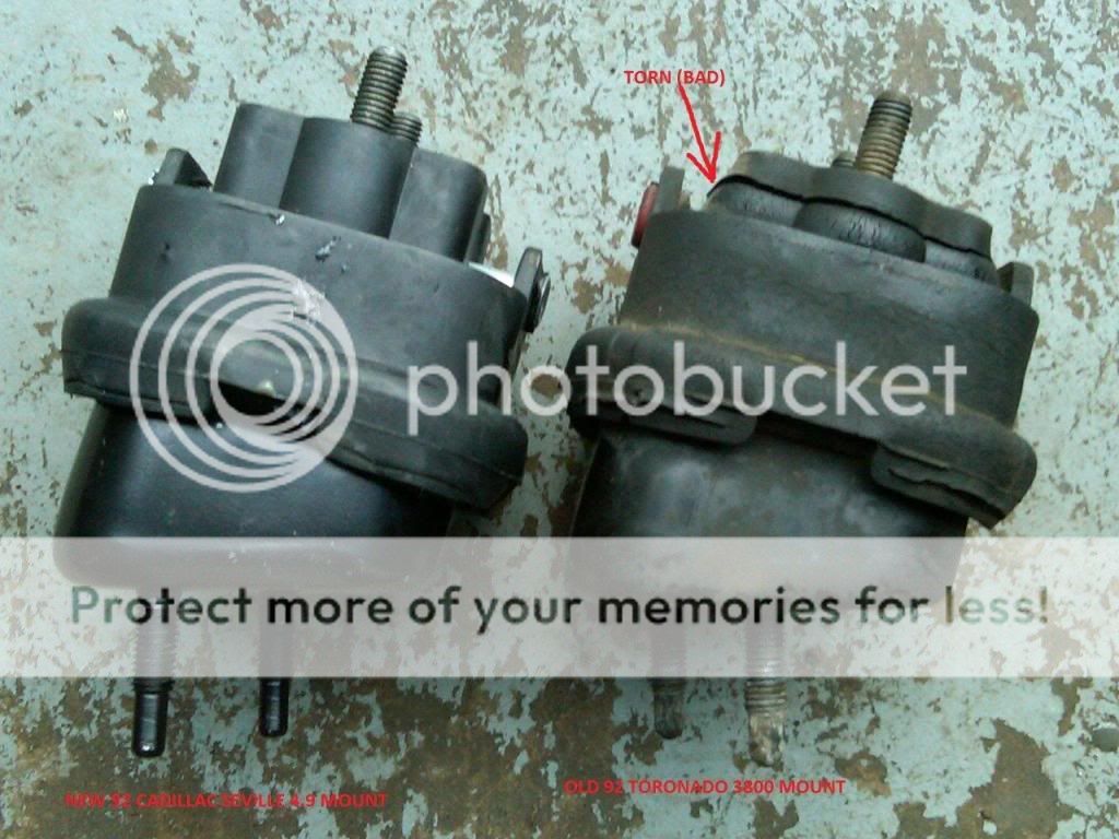

just a quick hint - the 92 seville 4.9 engine mount is almost identical. I will post pics as soon as I have some free time
Okay, great good to know this, interested do you know how it can be made to fit for Trofeo, yes do keep us posted, can see pics of Anchor mount #2836 from Rock auto web site: click Cadillac/1992/Engine/Motor mounts.

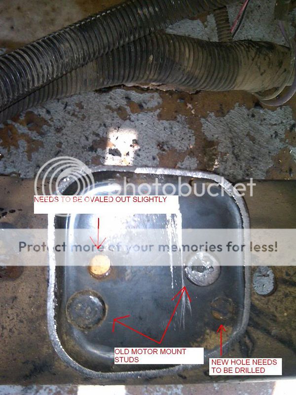

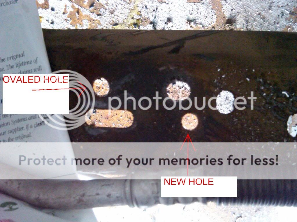

I strongly suggest you buy yourself the seville 4.9 engine mount and pull your existing mount. Once you do this you will see exactly what needs to be done. I cannot comment on the easiest way to accomplish the modifications with the engine still in the car as I have pulled both the engine and transmission in preperation for my series 3 supercharged swap that is underway. I suspect you could get to this area after removing the radiator, fans, and a/c compressor. You may not have to do all of this, I am purely speculating. Worse case, you could visit a machine shop and have the seville mount cut open, the studs flipped to the proper position, and have the bottom of the mount welded back together. Aftermarket Seville mounts sell on ebay very reasonable...
Looks promising no doubt very similar, thank you for the help, really appreciate this and you and your time.

I just wanted to shout a big THANK YOU to hammer489. I followed your suggestions and I was able to get the new motor mount in the 1992 Trofeo tonight. I really appreciate the photos, part numbers, and info. I was really sunk until reading your post, 👍 😊
The actual installation was done on a hydraulic lift. Drilling out the hole provd to be a challenge, but thanks to Hammer489 I am back on the road!
